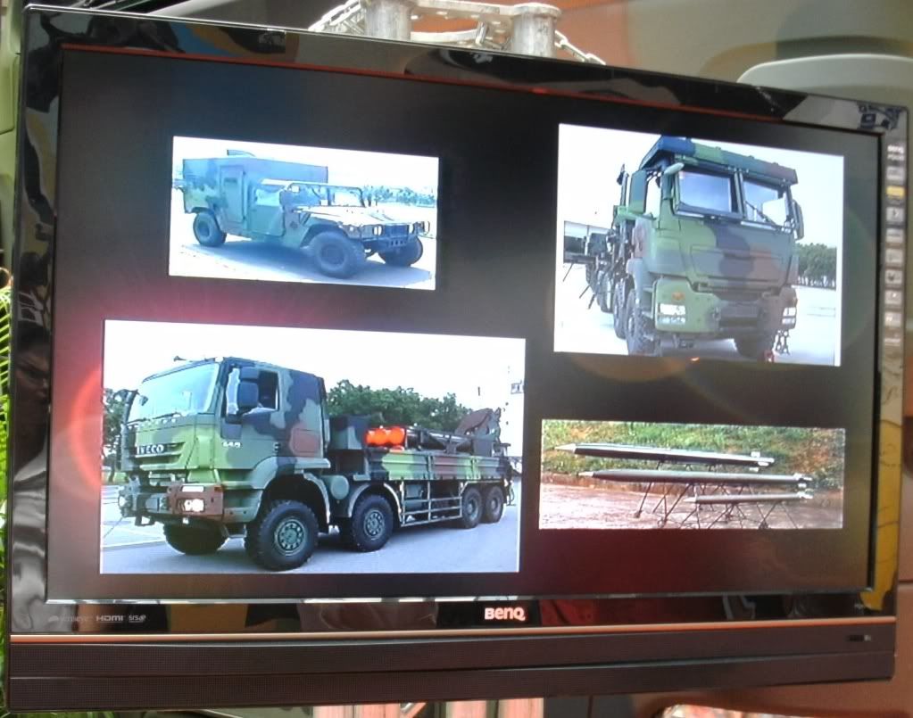

彈藥車是IVECO
指揮車用悍馬
Edited by - max03max on 08/15/2011 18:01:10
